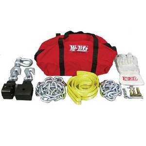

now what i learned from that. i tried to dig up mud and tried lift car at least one side and put some small trees under wheels. and that worked up for one side but other side was all in mud. and i had just folded but good shovel. and axe. and just small hidraulic lifter. which is enough to lift car from ground on solid surface but its doesnt work at all offroad. if i would had then hi-lift i would lift front of car enough to raise it from mud some and put some cut trees there. maybe would even got out . so my lifter was main problem. shovel was ok and axe too. and i found that now that i cut my front bumper and my recovery points are open its good point to lift car too. even with my small lifter i lifted it couple time by those points and all was fine. it was strong enough place to lift it. and i could even weld there something to make it more solid and good spot for good hi-lifter . so that stuff was missing. then again i could pull out car with hi-lift too. just need a lot ropes and chains and trees around. which i had .
so im now thinking what i could do to get out car and who could help me and should i just try to handle it myself by hands power. maybe i could. and it would be good practice to recover car. just weather is not best for doing that. hands frozen, all muddy , wet and such.
and i saw problem later. it was running water on that side where i got stuck. and running water made that part very soft and sinking surface.
maybe i just need some gear
and get to the work
i would need do that i think
