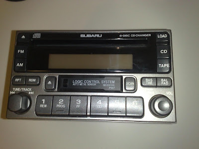

Here's the Subaru deck as fitted to MY03 Forester XS (I think X models had a different one, not sure about XT and Luxury models).
I after MY04 or MY05 they changed to a different deck with no cassette player and these also got the tweeters in the front doors and subwoofer in the back that mine lack.
